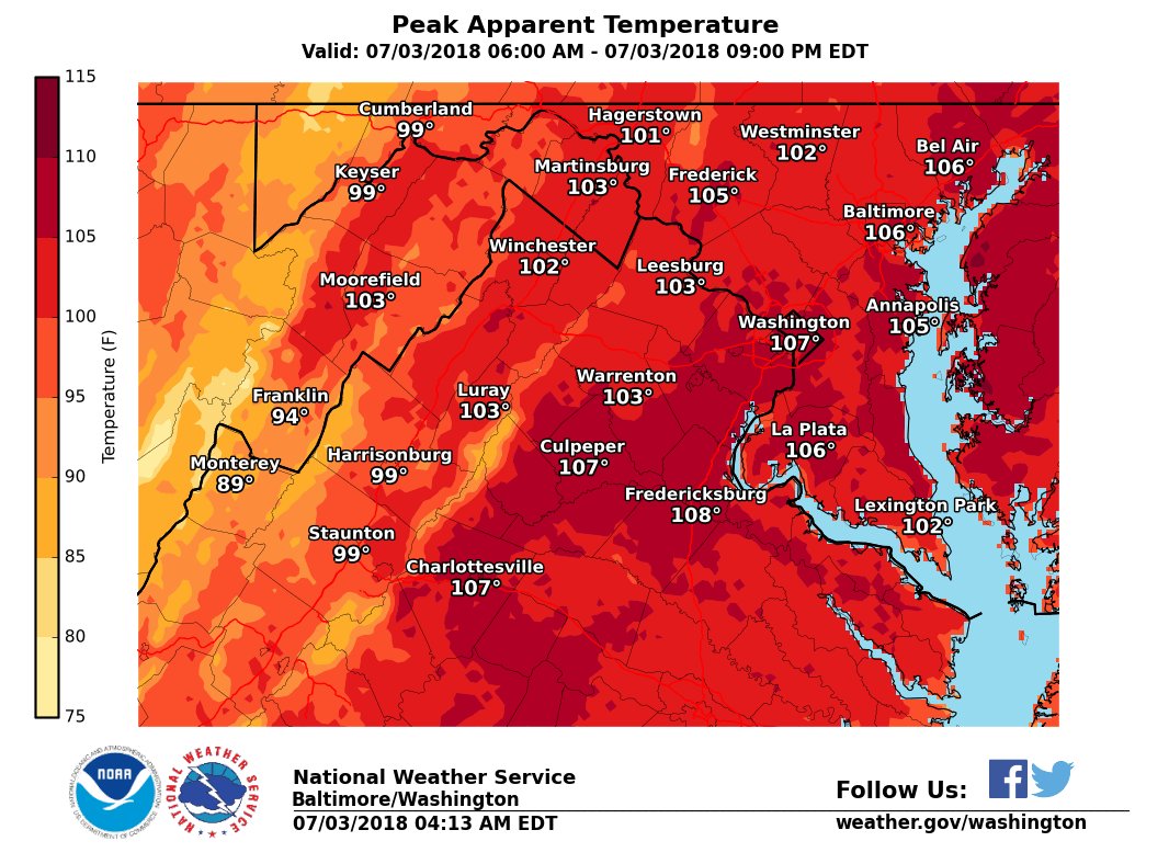

    @Dewey 179320 wrote:
    So with the National Weather Service publishing a heat advisory map showing 107 today in DC, how do you like to keep cool when riding in our hot and humid summer climate? Water of course, today I’m trying out a bandana I can fill with a gel ice pack
    pantyhose filled w/ ice stuffed down the back of the jersey.
