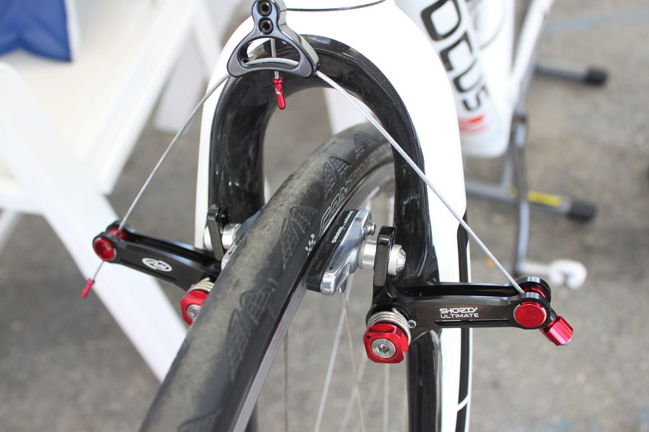

June 23, 2012 at 3:13 am #943994June 23, 2012 at 3:16 am #943995bluerider
ParticipantI took off Avid Shorty 6s and installed Avid Ultimates on my Blue Norcross EX. Love them. Mega power, easy modulation, and great adjustability. They were a huge upgrade over the original brakes. They can also be setup wide for mud clearance or narrow for power. TRP and Paul make nice cantis for cross bikes as well. But for the price Avid Ultimates can’t be beat in my opinion.
