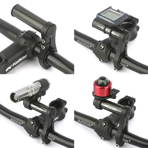

ParticipantI use “out-front” bar extenders on my main bikes as I do use the tops of dropbars quite a bit in my commutes. So my GPS/computer is mounted in front of the stem in those cases (it’s on my stem on my other bikes).
(I angle mine straight out, not on top like this.)If you google “carbon handlebar extender” or similar you’ll see they’re fairly inexpensive on fleabay, etc. I have an aluminium one too, but this is the sort of thing where I imagine there is almost no risk to getting carbon, unless you want to clamp a really heavy light. You can get them in various lengths too.
I can fit two lights and my GPS mount on the longer of the bars I have, which I use on my CX bike in commuter mode. It also makes it easier to swap over stuff from bike to bike – less cable entanglement etc. I do keep my bell on my bar tops but that’s it.
