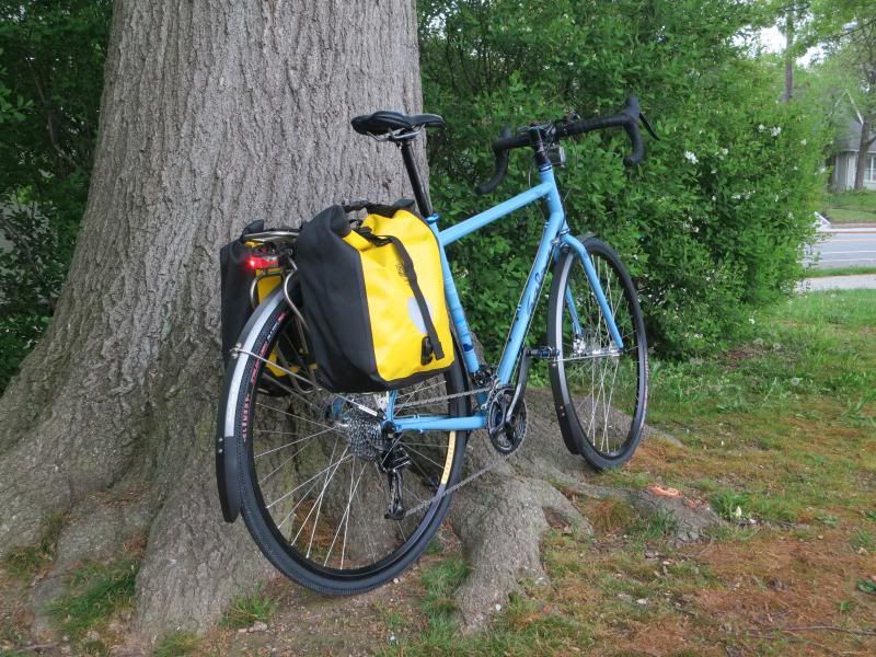

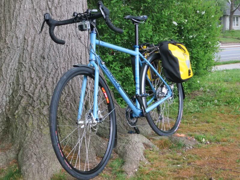

ParticipantThe bike looks great, but I wouldn’t cut the steerer tube! If spacers above the stem really bug you, consider flipping the stem so you keep more of that irreplaceable steerer tube!

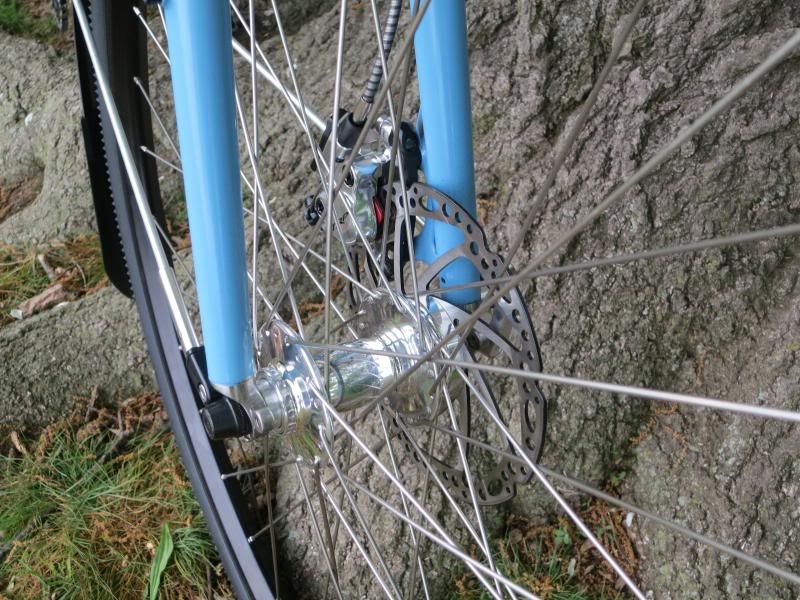

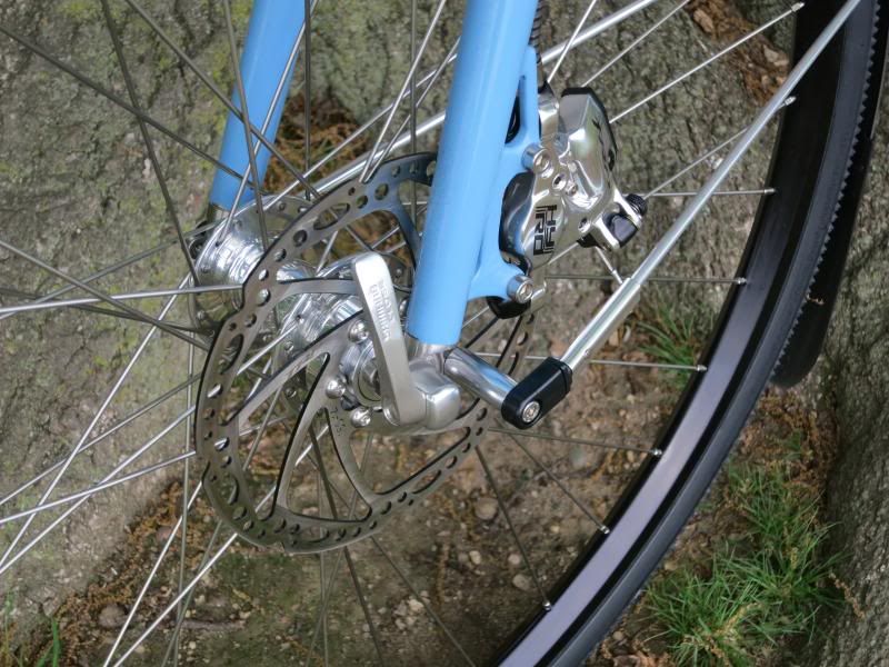

ParticipantNice build! How do the Hy/Rd work? Having used Spyres now for awhile on commuter and road bikes, I will say I really like them, but the stock rotors are not great; the brakes work much better (stop faster) paired with the Avid HSX rotors on my road bike.

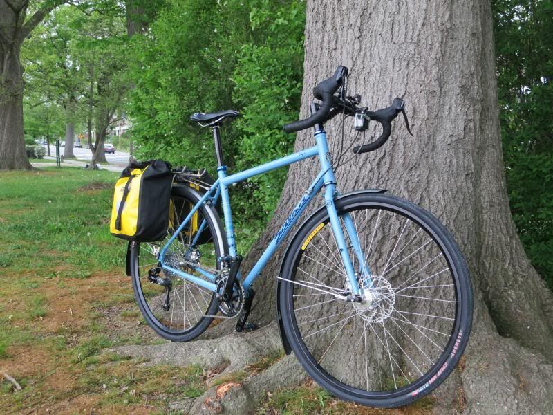

Are those old-school friction shifters?
I would definitely cut the stem, I dunno what peter_diy is talking about

Participantone real quick nit to pick – tho the spacer on the ND fork fender mount is clever, i’m seeing catastrophic failure the first time something whacks into that mount (and those rack/fender mounts are pretty easy to bend/ruin). what i’d recommend (of you’re not planning on running a set of low-boy front pannies) is to run the fender stays to the mid-fork braze on. not quite as classy looking, but much less exposed to possibly bending and ruining the threads on the dropout rack mount. my 2 pennies.
edit2 – you might even be able to run the fender stays to the interior mid-stay braze-on, depending on how wide the tires are and how tightly that bends the stays. might actually be pretty trick since you’ll keep the exterior braze-on to mount up some low-boys.
My experience so far at the shop is that they’re a compromise. They pretty much require the Yokozuna compressionless housing, and good luck getting the OEMs to spec housing that’s 5-6 times more expensive than bulk non-compressionless. If you’re doing a frame up build and use the Reaction housing, the HY/RDs will probably feel pretty good.

Yeah, I am running Reaction housing with the Spyres and they feel great, but you’re right that it is damn expensive stuff. My only other issue with the dual-piston design is that the calipers stick out more on the inboard side. I get spokes rubbing with (front) wheel flex with the BHS hubs. The Novatec hubs on road wheels don’t have this problem. I imagine the design is different enough that this would not apply to the Hy/Rd.

The TRP Hy-Rd so far is amazing. There is a lot of braking power and the lever feel is very nice. I read a lot of complaints about feel with SRAM levers. The newest version took care of this problem. The brakes are very impressive and super quiet.May 13, 2014 at 4:50 pm #1001060bluerider
ParticipantHarry,
I am waiting on a Tubus Nova stainless front rack to mount the fenders. The spacer is specifically spec’d by PDW for their fenders but I agree with you. Its a little exposed and looks a little strange. It will be changed soon. Thankfully, I didn’t need to use them in the rear.May 13, 2014 at 4:56 pm #1001061bluerider

I almost forgot. The shifters are sort of old school friction. They are SRAM 500TT shifters with the mounting bodies removed. Then mounted on Paul Components Thumbies. Indexed in the rear, friction on the front. Easily accessible with my thumb and fore finger. Plus, DIRT SIMPLE.May 13, 2014 at 4:58 pm #1001062bluerider
