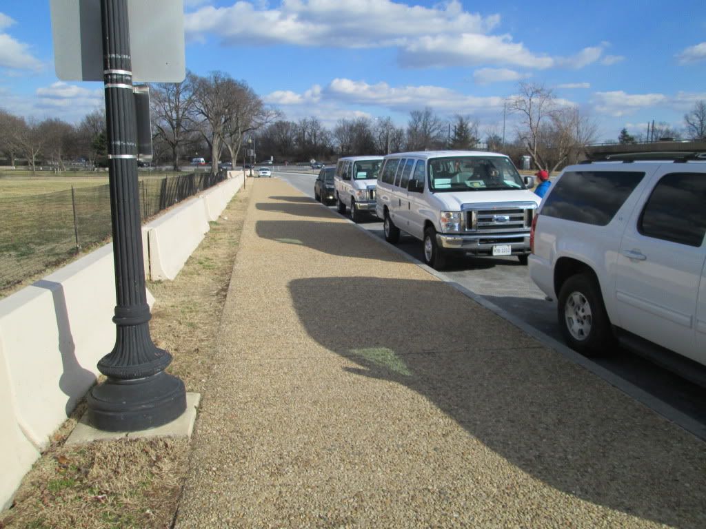

    I highlighted the challenges with crossing East Basin Drive and getting on the sidewalk during tourist season. We discussed the possibility for converting the “no standing or stopping” parking area into a 15th Street cycletrack style bike lanes. The cycletrack would extend for the block and would deliver cyclists to the curb cut east of the Jefferson driveway. For that to work would require active enforcement regarding the “No stopping or standing” prohibition.
    I guess I’ve never noticed any signs stating it’s a no standing/stopping area but does that mean the vans are parked illegally above?! Wow. And all those tour buses that stop there? And cyclists get ticketed for not putting a foot down at the stop signs at Hain’s Pt. Does not compute…

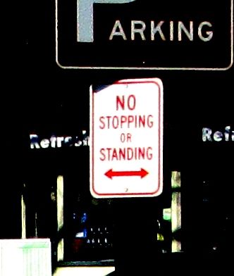

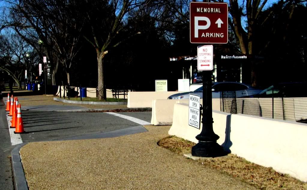

    Most motorists don’t appear to have noticed them either.
    Here are a couple of photos that show the front of the signs you can see in the previous post
