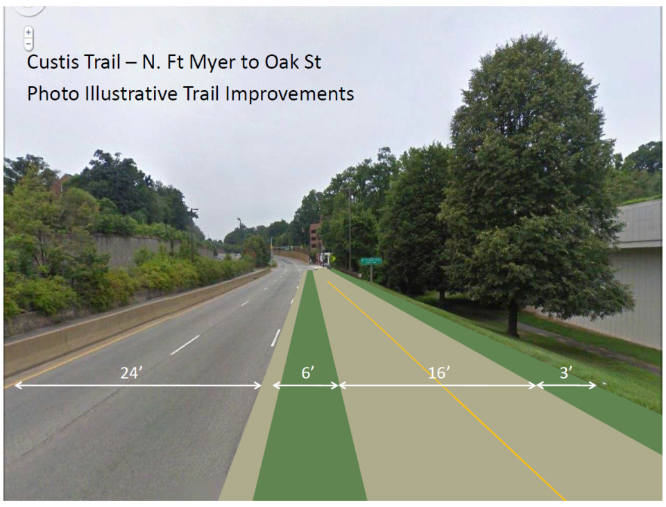

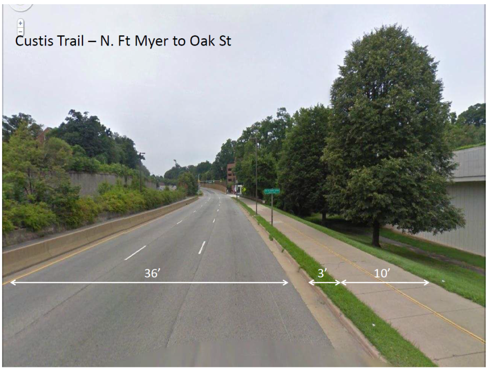

    Would you settle for widening the trail to 16′? :) Coming as part of the long-delayed, abysmally-named (but still coming) N. Lynn Street Esplanade and Lee Highway/Custis Trail Safety Improvements
    16′ Custis from Lynn to Oak + a planted buffer between the road and the trail. This also helps the sight-lines quite a lot at the Marriott Driveway.
    BEFORE:
    AFTER:
    #995809
    While the above would be a nice improvement over the current situation, I like the proposed idea of a buffered cycletrack to the Custis turn off before Uhle St better. I see more conflicts on the section between Scott and Oak than I do in the Oak to Ft Myer. I think much of that is due to the curving nature of the trail in that area and the sound barrier wall right along the edge of the trail. Lee Highway would not lose any space over what is proposed and the using a cycle track next to a sidewalk would help limit bicycle/pedestrian conflicts. Only going as far as Oak is short sighted.
    #995811
    MattAune
    But that is going to end where the sound barrier starts, no?
    I would much rather have a 2 way cycle-track that goes all the way up the hill over the 66 bridge and join in where the trail makes the 90 degree turn.
    #995836
    runbike
    Can’t agree enough with the two previous posts. Protected cycle track removes potential bike-ped conflicts completely. With the added benefit of far less constuction required to implement! If the county is willing to go with killing a lane for the “esplanade” project, I can see absolutely no reason why they wouldn’t get behind the cycle track…cheaper and more effective!
    #995849
    1) I agree.
    2) This ship has sailed.
    #995858
    bobco85
    I like the trail widening in general, but I do wish they could continue it to the 90 degree turn on the Custis. That would involve removal and reconstruction of the sound barrier between Oak and Quinn which would be expensive, but I think it would be worth it.
    My main concern about the widening design is that the curb cuts at the intersections may still force opposite-traveling people toward the middle of the trail. For example, if you want to cross Ft Myer Drive, even though the trail is 10 feet wide, the awkward angle and shape of the curb cut actually only give a few feet of space to maneuver.
    I never even thought about having a cycletrack along the right lane of Lee Hwy up to the 90 degree turn on the Custis, and I think it’d be great if they decided to do that. However, I don’t know how they would justify to Joe Car Driver that they removed a car lane to put a cycletrack right next to a trail (unless they made that portion of the trail pedestrian-only).
